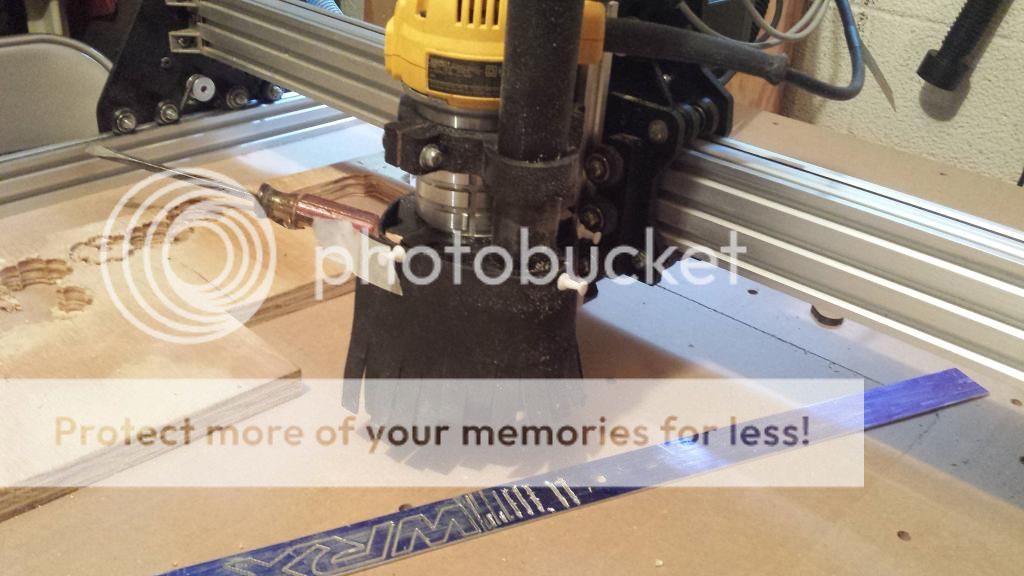

    Another thing that I had to tackle was mounting my dewalt 611. In the pictures you can see I went with a pretty simple mount and then modified it to hold a shop vac hose for the messy machining operations. I also made an air diverter which I found in the shapeoko scene. This keeps the dust from being blown every direction by the dewalts exhaust air.
    (A quick and dirty dust shoe that is super easy to make, and the foam(from michaels or AC Moore, a craft store) is super cheap. So its not a big deal to replace when/if it gets torn up.)

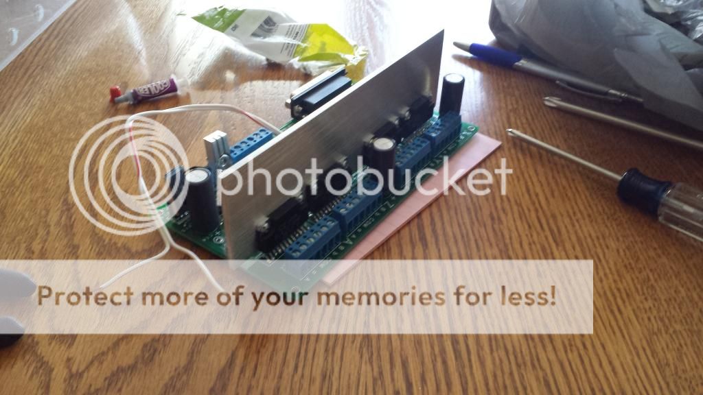

    I supposed I should talk about my electronics at some point as well. I'm using a HobbyCNC pro 4 axis kit which I soldered together (and I believe is not being sold anymore). This driver board has a parallel port built in which talks to Mach 3. Something interesting about this board is that It only allows the use of unipolar stepper motors (6 and 8 wire steppers). I got the steppers from (http://www.kelinginc.net/) and I'm very happy with them so far. I wired all of my motors to terminal blocks on the machine themselves to facilitate easy tear down/replacement if required. It doesn't look as pretty as some of the other builds but I value function over form in this application.

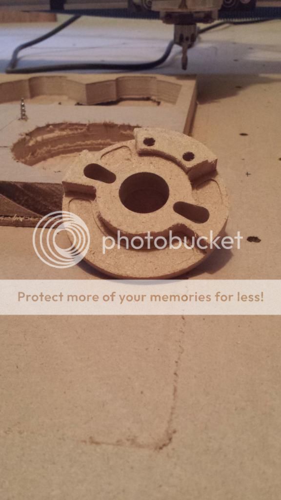

    Here are a few 'things' I've milled: Everyting from MDF to Aluminum.
