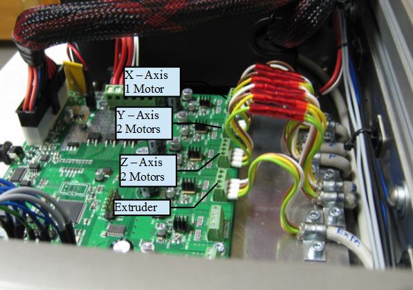

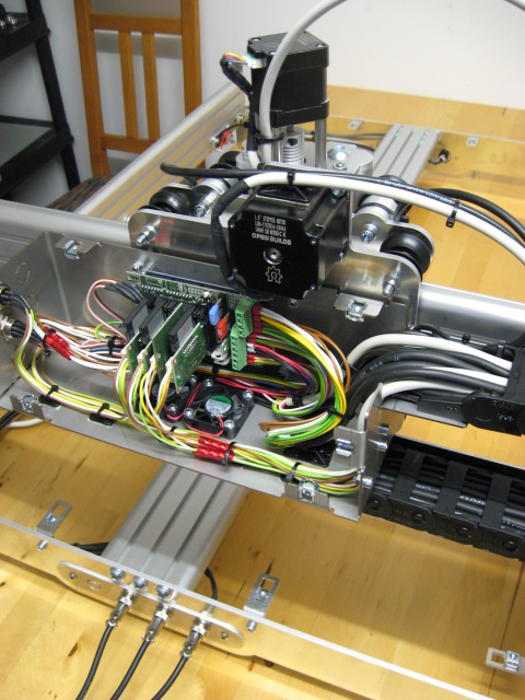

    Hi Vill,
    the Echinus controllerboard have six bipolar 1.5 A stepper motor drivers (http://echinus.org/). With this controllerboard you can powered a motor up to 1.5 A. A good chois is a Nema 17 motors (http://openbuildspartstore.com/nema-17-stepper-motor/) he operate with DC 1.68 A/Phase.
    For the Y and Z axis I use two motors per axis. I connect two motors on one driver output.
    I think for the use as a 3d printer or similarly, is the nema 17 motor a good choice. But if you, need a little bit more power (like a router/ mill), you should be use a motor with more power (Nema 23) and a controller with also more power.
    For my current project I use the Bam & Dice board (http://www.2printbeta.de/Electronics/Controller/BAM-DICE-Arduino-STK-kit::328.html?language=en). It´s based on a Arduino board and have enough power to 3D print and milling!
    I hope the information is helpful for you!

    @AK-Creation:Hello AK,sorry to trouble you again!I have carefully read what you have told me last time,but I still have some questions.
    Q1:You said the Echinus controllerboard have six bipolar 1.5 A stepper motor drivers,does it mean that the controller board has combined the control board with the stepper motor drivers to make the special controller board?
    Q2:You said you have choose a Nema 17 stepper motor for your project.And I'm curious about that.how do you figure the load(it seemed to be unkown) in each axis to make sure your motor can match?
    Q3:I'm not good at the construct the control system,specially in connecting the two electronic part such as the controller board and the stepper motor and so on.And I have no idea about an Arduino board ,especial in the function of the port.the picture is my board.Would you mind telling me more about that?

    Hello Vill,
    I am glad if I can help!
    To Q1: Yes, the Ehinus board is two in one (contollerboard and stepper driver in one). To explain: (http://www.echinus.org/wp-content/uploads/Installation-instructions-Echinus-V1.7a-English-V0011.pdf)
    To Q2: At my beginning to build the 3D Printer, I search a controller board that can powered the Printer. The performance can powered 1,5 A per stepper motor. So I search a stepper motor what use 1,5 A. The Nema 17 take 1.68 A. So I decided to Nema 17 motor. For the 3D Print is it not so critical. You dont have so big shear forces.
    But the experience what I have done: If the build (3D Printer) greater, than is the print speed slower. If The "small" Nema 17 motor have a acceleration and a suddenly direction change, so have the "small" Nema 17 motor problems to stop the big mass. So it is better that the greater printer accelerate slower, than he can better slow down the speed.
    Whether a motor can manages the load, I have found the answer by testing. (example: by my milling tests with the Nema 17 motors is my result, that the motors are to weak. So I use Nema 23 by my next project. And test it again.)
    To Q3: Honestly, I also have the most difficulty with the electronics and software.
    Your board is a "Aruino uno". The Bam & Dice based on a "Arduino Mega 2560"!
