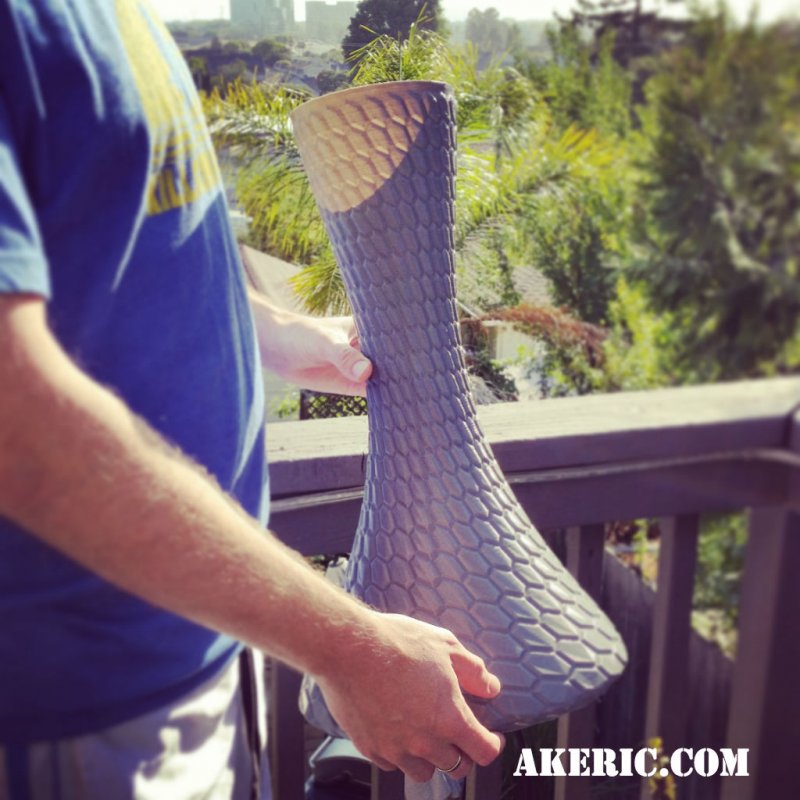

    @craftygeek, as far as fans go for filament cooling, I'd picked up a pair of generic 40mm ones... I'm guessing they put out 4cfm each. But since I'm running a Volcano nozzle that has over 3x the volume output of my rep1 (who's cooling fan is around 8cfm), my prints aren't getting cooled enough.
    Figured I'd go big, so have a pair of these on order:
    http://www.ebay.com/itm/121440135582
    20cmf each. Not sure, may lift my machine off the ground, but I figured in my case I need to get a lot more airflow to cool down the 1mm nozzle worth of plastic coming out.
    For cooling the Rumba board stepper drivers, the standard ones I mentioned above seem fine so far.

    That is some serious fan! Nice print, looks good.

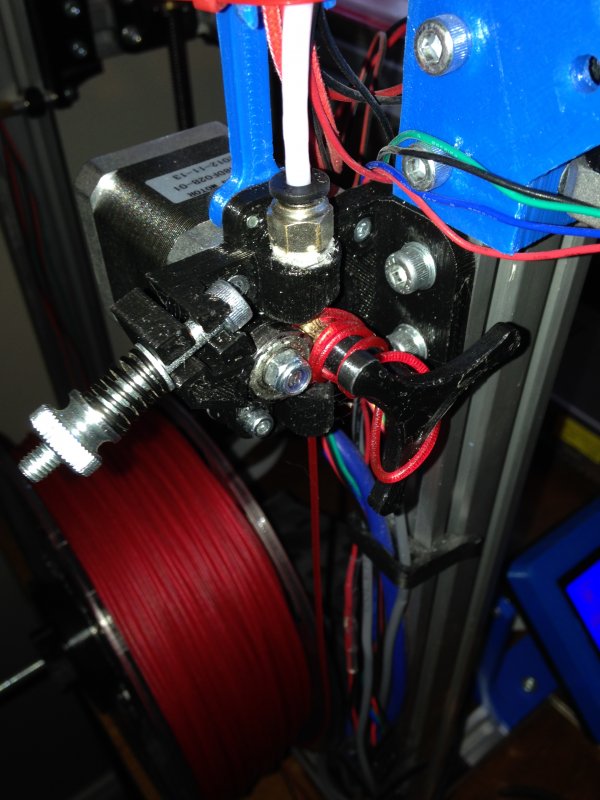

    That drive gear do you have on your extruder? I bought a cheap MK8 when I was buying all the other parts from China and I am getting slippage. I'm trying to figure out if the hobbing is just garbage (it doesn't appear to really be cutting into the filament at all) or the radius is wrong or I messed up the extruder design when I made the holes bigger to accept the quick disconnect fittings I had.
  26. Carl Feniak
    Carl Feniak Journeyman
    Mar 18, 2014
    654
    246
    Fair to say that you've already tightened up the idler spring to give it more biting force? Also, are you sure the filament is skipping and not the motor skipping steps backwards?

    Yeah I've got a pretty hefty spring on there and I've got the force such that I have concerns about breaking the little arm off. I inserted a piece of virtual filament in the 123D model and it appears to intersect where the gear should be, but I need to take off the gear and measure it to see if it is right. It does appear to be just the filament slipping but it is hard to tell because it only slips a little at a time and the gear is so tiny it is hard to see if it is moving. The bearing definitely snaps back a bit. It still prints but it happens every 10-20 seconds when printing at full speed so I'm sure it is affecting the quality of the print. I just wanted to make sure we were using similar dimensioned gears and the model wasn't designed for like a 8mm diameter gear and I was putting a 6mm gear in.
    I was thinking about building one of Airtrippers extruders with the load cell in it that can tell me exactly how much force it is trying to push. Seems like a fun little waste of time!

    So here's a closeup of my "MK8" extruder gear which I got China-cheap.
    It has more flat part than bitey part so I am guessing that's why my filament is slipping.
