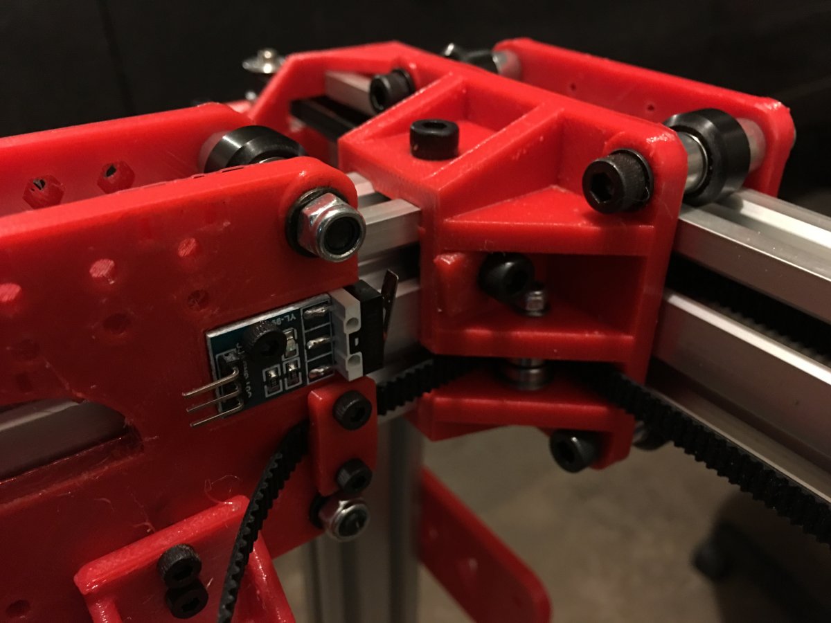

    Bumper now added into design, thanks. Easy to miss these little details when you are designing for parts you don't actually have. On that note: my switches arrived today! I hope to try out the direct feed extruder option soon.

    Which switches did you get? I ended up grabbing a variety of them, Keyes, YL 99, MakerBot 1.2 and have a bunch of generic mini switches from other projects. I noticed that the YL 99 and MakerBot 1.2 are both normally open switches. I modified the YL 99 to be normally closed, might do the same on the MakerBot 1.2. Have not tried the Keyes type yet...
    Looking forward to hearing how the direct feeder extruder works out. The design looks simple enough, have not added it to the generator yet, FRC consumes my free time and probably will do so until March... :) Oh and I am going to abaddon the thingiverse customizer. The code is already a jumbled mess because the customizer doesn't import files... So when I get back to coding, I am going to split this up, clean it up and start adding more options. If anyone has any requests, let me know, will add it in.
