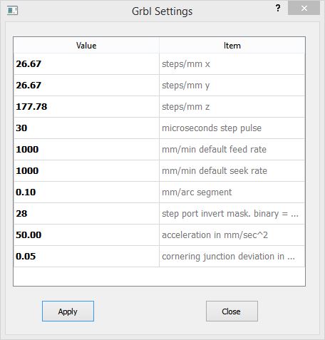

    Ok these is what I got.
    copy of the ox build the only difference is the size
    X and Y axis nema 23
    Z axis nema 17
    Xpro board
    power supply 24 volts 15 amp (Tried an ATX power supply as well)
    grbl v 0.8
    windows 8.1 and windows 7
    This is a video of the machine moving and trying to cut a 1 inch diameter circle it makes a weird noise and I don't know what is wrong can some body help please.

    First, why are you using two steppers on your X but only one for Y ? X is the left-right axis, moving the assembly carrying Z (up down axis). This leaves Y as the front-back movement, typically needing the two steppers as it moves "everything" in most 'OX' configurations. Then again, one can change things around as needed by their design.
    You could connect two steppers to one driver, but it is not recommended (load on driver). Especially when the controller offers slaving to an other (spare) driver.
    As for reversing a stepper, only reverse connection to ONE of the two coils, leaving the other unchanged. I believe GRBL has a setting to achieve the same thing ... a bit of "calculation" to set the respective value.

    Your motor issues I can say almost 100% is due to a bad ground as for scale I believe your issue may lie in the settings "step rate" or something silly

    Do you have the micro stepping set right for the 26.67 steps/mm? Should be 1/8. It sounds like that. The Z doesn't do it, because you are closer to the right settings for that one (200 steps/mm).

    the voltmeter image is for the amps wen the Y axis move ( I'm not an expert so - 0.26 A reading means ???)
    The xpro is set for 1/8
    I'm learning as I progress with the build so wen I finish I will post it focusing on people like me that want to get in to machining (Like my kids they don't sop bugging me to let them play with it)
    The 1 inch circle file got to be wrong because I measure the distance wen it moves and is very close to perfect but X and Y motors sound and shake a lot Z motor not so much I use a link for a calculator for the shapeoko cnc
    The wires are different color because that is what I got on hand for extension but the wires are connected the same as picture 1

    A few things from the pictures you posted.
    1) The blue wire that is tying the xPRO to the ac (green) ground needs to be removed. This wire is effectively creating an ac-dc ground loop - not a good thing with switching mode power supplies. This wire is redundant but if you would still like to you it please wire it to the V- of your power supply.
    2) In one picture you have jumpers set for 1/8 microstepping and in the other you have them set for 1/32 microstepping - which of these will be your run state? This will effect your steps/mm setting (scaling).
    As for the noise - here are the first things to try:
    1) Adjust the current settings on the motor drivers - the motors you are using can pull up to 2.8A. Try adjusting the trimpots right above the ustep jumpers. Either do this with a non-conductive screw driver or power off the board before you make adjustments ;).
    2) Check that the axis are free moving by hand - no binding or pinch points.
    3) Also check the belt tightness, too much tension on the belt will put a strange load on the motor axle and cause the motor to do strange things (learned this one first hand on one of my first builds and it took forever to find :banghead:).
    4) Adjust the acceleration to 25 instead of 50
    My bet is on the ac-dc ground loop and a combination of 1 and 3 above.
