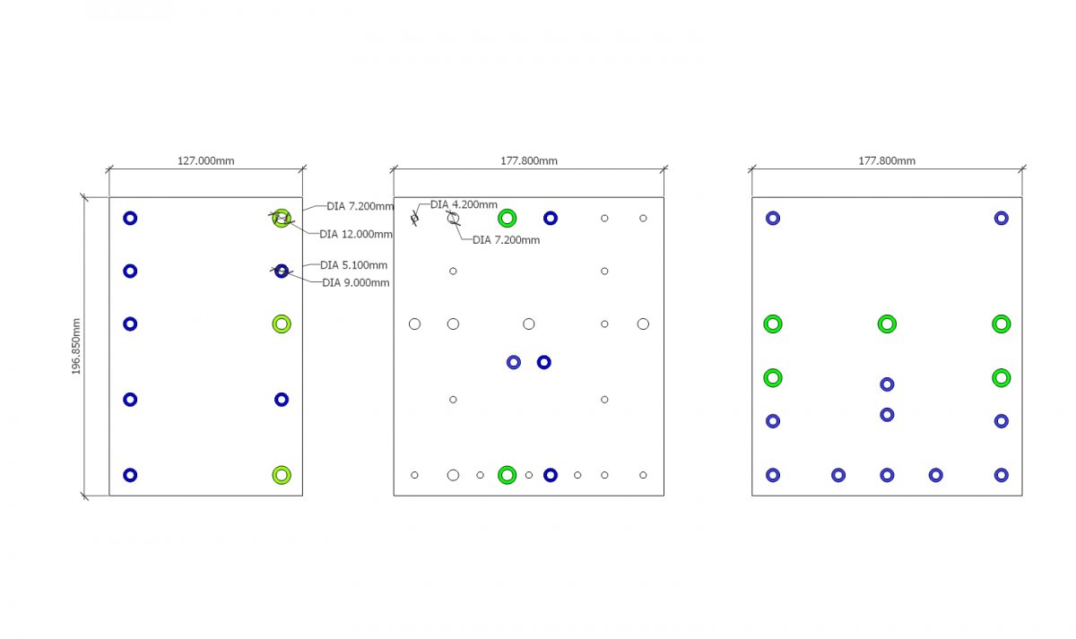

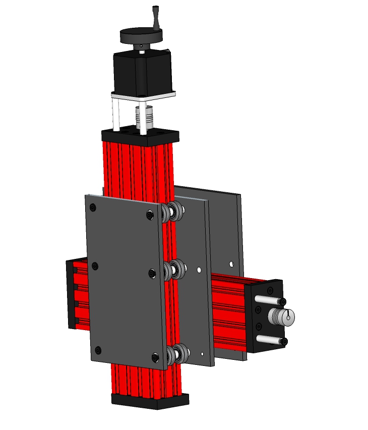

    I honestly don’t really know what all I would like to do with my CNC. So I designed with the idea that I may want to some bigger items. I have been fighting play on the X and Z axes a bit. So far I have just been doing some arts and crafts (to get some learning / practice in) type projects so accuracy hasn’t been an issue. You can see in the last few I photos I posted that I replaced the C-Beam on the side for ½” x 7” aluminum flat bar. The issue I had with the c-beam was the connection. The original C-Beam Gantry Plate just didn’t have a large enough foot print to over come the leverage created by the vertical height of the X axis. The new aluminum bar and wheels spread out has greatly reduced the play. Now I am thinking of replacing the V-Slot Gantry Plates where the X and Z axes connect with 1/4 “ x 7” aluminum flat bar. I think doing this will make it play free.

    Have you worked out the issues with play on the axis's?

    I haven't worked out all of the play yet. I am hoping to when I get a chance to make and install these plates.

    I will try my best. I just ordered the Aluminum Flat Bar to make some bigger plates to replace the plates connecting the X and Z axis.

    I recommend you lower your plates, since the higher they are the more leverage there is (or, add smooth bars and linear blocks to enforce it) and consider mounting your Z axis "properly", like in the Cebu thread
