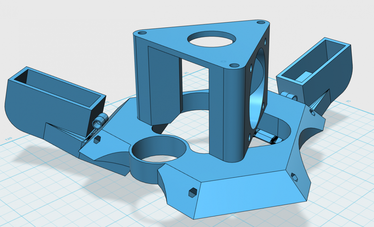

    So I've made some progress and I've got my Delta Six running. I still need to tidy up the wiring, install a proper heated bed etc, but it works as is.
    I've been using the effector which Arondite was using for a while, but my blower fans are larger than his and they where constantly cooling down the hotend. So I designed my own one and I wanted to try and incorporate the print cooling fan as much as possible. I got the idea from this cooling duct I had on my i3 for a while. This is the end result, which I'm extremely pleased with:
    If anyone's interested, the design can be found here
  27. r0n_dL
    r0n_dL New
    Jun 7, 2016
    The effector looks really nice. Anyway you'd be willing to remix it to use a BLTouch? If not, would you be willing to share the STEP files that can be edited?
  28. Nilz
    Nilz New
    Oct 24, 2016
    I'll try to if you can give me the correct specs. I tried Googling them but there seem to be variations of the specs.
  29. Arondite
    Arondite New
    Mar 18, 2015
    36
    15
    Nice! I've actually been having the same exact problem, especially since I threw on a volcano hotend. I really like your effector, I've been scratching my head trying to figure out the best way to add a layer fan duct thing, exactly like you did in yours, for quite some time now.
    Another solution to the layer fans affecting the hotend, is to wrap the heater block of the hotend with silicon or fiberglass tape. that will protect it from the airflow and give you extremely stable temperatures. I'd suggest doing that a bit with yours anyway, it looks like the heater block is touching the effector a bit in your pics.
