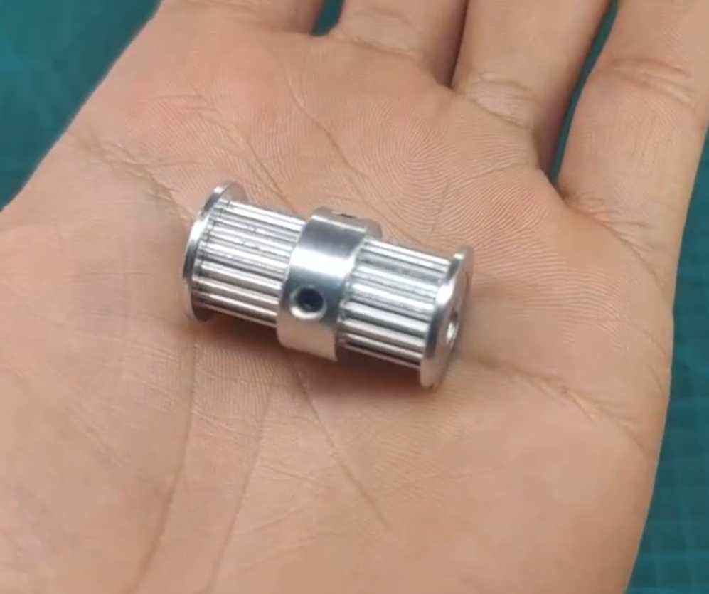

  15. pauna
    pauna New
    May 18, 2016
    54
    13
    hi
    Have you ever seen this GT3 timing pulley? The GT2 timing pulley is shown in the photo.
    I couldn't find the GT3 dual timing pulley anywhere.
    Do you think a double belts won't work on the "worker bee" X axis? Screenshot_20240119-011159~2.png
  16. Rick 2.0
    2,861
    1,528
    Not quite what is meant by dual belts. The dual/double belt system refers to two belts facing into each other with the teeth interlocking to prevent belt stretch. See video above.
  17. pauna
    pauna New
    May 18, 2016
    54
    13
    Of course, I know this, now I was going to install two belts with the above system, but as it turned out, one of the old belts will not fit, I need both new ones and I bought them on the Internet.
