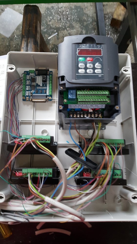

  13. shining
    shining New
    Mar 29, 2016
    Hi peaple...
    Iam still working on my build and meet lot of problem....
    I wanted lot of torque so i choosed 5A motor....but the driver i choose look like poor product... iv burn more than 6 driver on x axis (2 motor whiy slave)
    If i let power whitout moove it become warm and blow....
