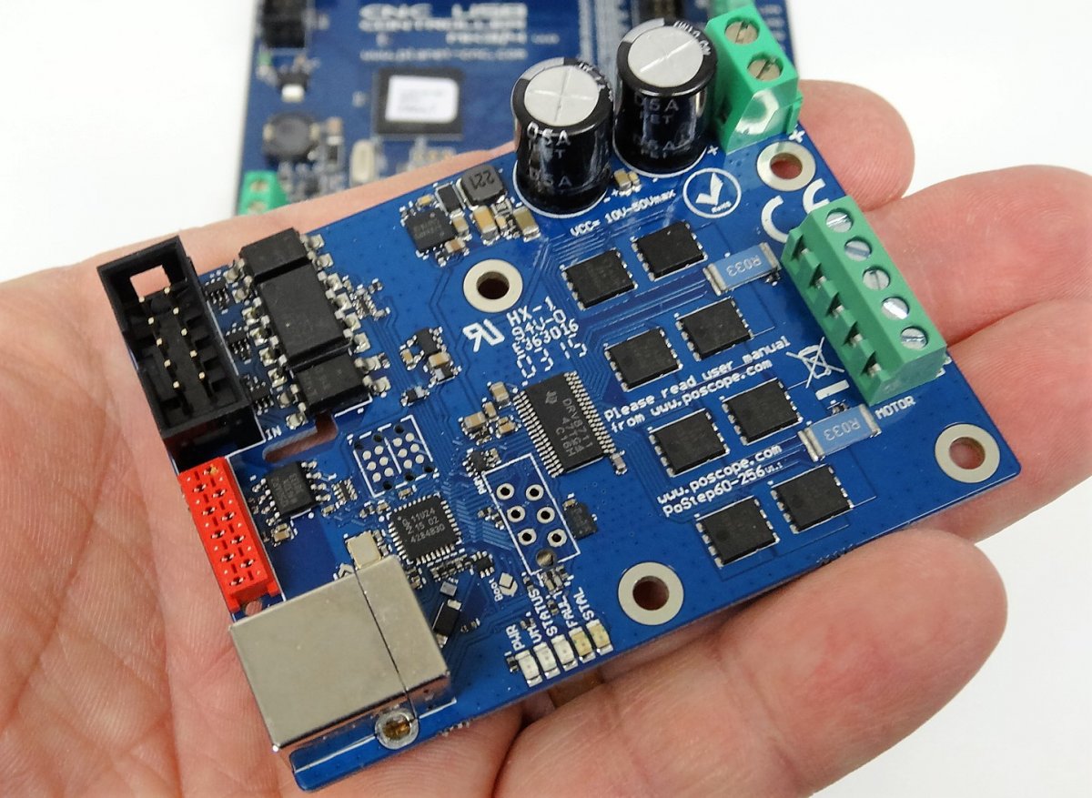

    The thing to keep in mind is you are not only limited to just the A4988 / DRV8825 Drivers when you are using a cnc hat / control board that makes use of removable pololu based drivers.
    Here is one combo I have considered for a C-beam machine build, Raspberry Pi Running Bcnc / arduino running grbl / thb6064ah drivers.
    Raspberry Pi CNC Board / Hat | Protoneer.co.nz
    6064A: Adapter cable Pololu massmind
    6064: 4AMP Stepper Motor Driver Kit. massmind
    I also like the idea of using a G540 (or other parallel port based driver / bob package) with a beaglebone black running machinkit image using one of the many parallel port hats.
    Mark, any info on this piece of hardware I found floating around the web? :)
  30. Mark Carew
    2,745
    2,411
    Hey where did you find that pic! :D JK not yet @Kyo we have some ideas in the works but nothing solid yet. We are working toward an open source solution with components that are as high end as some of the standards out there.
    No ETA yet but it is in the works. In fact, there are lots of new things in the works here at OpenBuilds HQ that we can't wait to share so keep an eye out ;)
