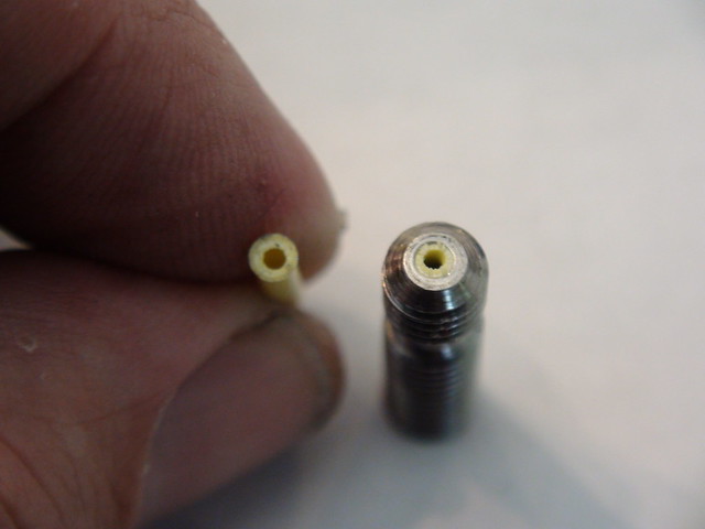

    I have been really in the hot end rabbit hole. Some more quoting of Jetguy.
    >You guys are endlessly chasing down a nozzle problem when the jam is ALWAYS in the thermal barrier tube.
    Yes.
    And why it is in the thermal barrier area instead of the nozzle area?
    The original poster here actually had that problem a blockage NOT in the nozzle area but much higher up in the thermal break area of the nozzle.
    Here's how to find that out.
    Say you have an extruder jam and you find out that you can no longer even feed filament into it manually while you know that it is preheated to the melting temp of the material (195-200C for PLA or 210-230C for ABS).
    You let the nozzle and heater block cool to room temp and carefully remove the nozzle. If you are very careful and do this correctly, you'll pull out a molded filament shape like this.
    Some notes about this any why it is extremely important to the discussion: This is an original QU-BD MBE9 thermal barrier tube that is a straight through bore of ~1.9mm with NO step at the heater block side.
    The current Flash Forge PTFE tube creates the exact same problem.
    Now, before you haul off and jump to conclusions saying all that proves is there was plastic all the way to the nozzle check this out:
    The same end snapped off revealing the entire section in the nozzle was hollow!!!
    Now, this next picture is the "money shot"
    The location of the jam in the thermal barrier tube is shown by the allen key beside it. It is impossible to push this jam out by mechanical force in this state. The jam is ONLY about 5mm long but is solidly bonded to the thermal abrrier tube walls.
    In fact, extensive testing and comparison with others in the QU-BD forums show they too experienced jams in the exact same location. Swapping a different nozzle will not clear this jam.
    Again, there are some key indicators here. Air is compressable, liquid is not. If the jam was in the nozzle tip, then you would expect to find no trapped air or hollow space because the rest of the filament further up could have easily pushed down on the air pocket. Instead, we can determine that the jam happened after a retraction. The molten filament was pulled up from the nozzle area into the cooler heat break and jammed against the walls. Because this area is not hot enough to keep the filament molten, the jam prevents any further filament from feeding. The EXACT same type of jam is happening in the PTFE tubes for folks.
    What is KNOWN is that the genuine MK7/MK8 thermal barrier tube system NEVER does this. The facts before us are simple. Both designs that jam use a single smooth bore system all the way to the nozzle of only about 1.9mm diameter.
    The systems that do not jam are #42 size (2.3813mm) bore in the hot zone. This is easy to see what the hot zone is by examining the heater block
    Common sense, if the heater block is 230C(or whatever your set temp is) then the parts directly threaded into it are the same or nearly the same temp within probably 10 degrees.
    Let's examine a lineup of thermal barrier tubes.
    The upper left is a genuine MK7/MK8 MakerBot OEM thermal barrier. The next one down is a QU-BD one modified by drilling with a #42 drill bit for 10mm to exactly match the MK7/8 one. The next is an all orginal untouched QU-BD with the stright 1.9mm bore. The last bottom one is the current Flash Forge with the PTFE removed. If you look closely, you can see the stepped bore in the MBI one and the modded QU-BD one whihc perfectly. The original QU-BD one jams like mad but I ket 1 of mine stock just for reference.
