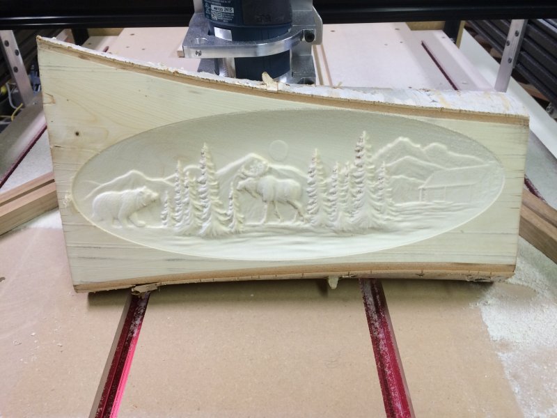

  6. Mark Carew
    2,746
    2,412
    Hi @superelvis I will jump in here if I may,
    Yes you can mill 3D patterns like this using the right tool pathing cam software. ArtCAM for instance
    In fact I find its easier to cave then it is ti cut all the way though materiel.
    You would use step down cuts removing a little material on each depth cut.
    Check out this forum post
    http://www.camheads.org/showthread.php?t=3401
    Also have a look at this Standing Wave Generator Resource
    http://www.openbuilds.com/resources/standingwave-generator.84/
    Hope this helps
    silopolis and superelvis like this.
  7. Robert Bailey
    Robert Bailey Well-Known
    Mar 23, 2015
    117
    71
    Don't see why it wouldn't, I am trying 6061-t6 aluminum which is some hard stuff, the softer materials so far are a breeze. I cut almost 200 holes in the work surface into mdf and didn't even break a sweat.
    look at the area-51 build and videos he is doing signs in wood and throwing wood chips everywhere.

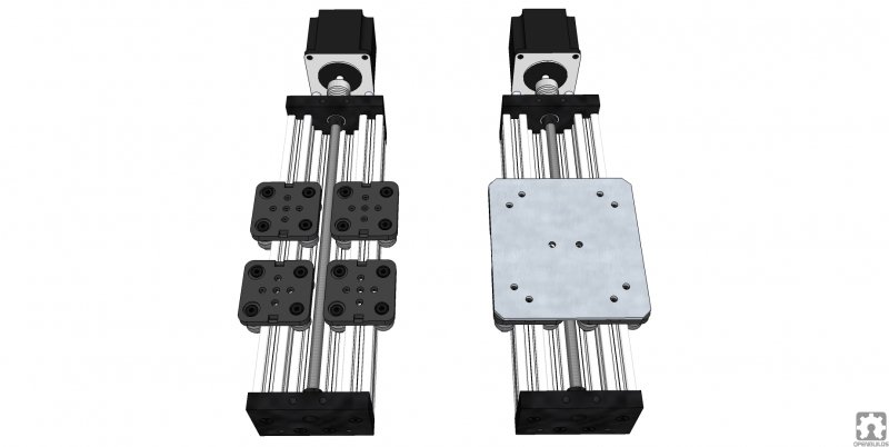

  9. leversole
    leversole New
    Nov 1, 2015
    77
    14
    Any progress on this? I am thinking of build my Ox with all C-Beam...I assume the nut block is attached with the two screws thru the top? Do you have this idea in a sketchup file? You can post or email me if you like...
    PS...I really appreciate all that you have done in/for Openbuilds...I am am going to end up with a machine I could onely have dreamed of before!
    PSS...I went back and looked again, would this be a good design for the Z axis?

  13. Robert Bailey
    Mar 23, 2015
    117
    71
    here they are, this is our current design, I have a coworker draw these up in solid works. me and another coworker are in the process of a redesign to incorporate our rear wheel add-on as seen in the previous pictures
    I have uploaded. our new design for the gantry will set the spindle back a couple inches, I have several plates that are 14"Hx10W so I am making it fit that dimension. the new design will also is also using a
    22mm bearing that has a lip to hold in in instead of having a pocket. as it sits now we are able to cut wood, aluminum and plastic. more updates to follow in the next week or 2.
    silopolis likes this.

  15. Robert Bailey
    Mar 23, 2015
    117
    71
    Found an error in the X plates is is .9 mm off on the wheel spacing , based on the universal plates. might be why I was having problems setting up the wheels
  16. SteveB05
    SteveB05 New
    Nov 24, 2015
    Ok. I'll make that adjustment and verify against the plates that come with the kit when it gets here. What I was thinking is running the X axis C-Beams with the screws to the outside (like yours) with the x-plates on the outside and have the risers on the inside. That should reduce the deflection in the C-Beam without adding drag by putting more of the moment of the force on the solid side of the C-Beam. Also want to do that on the Y axis beam (screw to the back). I think this will give the best rigidity available this side of a fully supported rod setup while keeping the screws as clean as possible. Thoughts? This is my first build of a device like this and I'm not an engineer. I don't see anyone else doing that so I might not be thinking about something.
  17. Giarc
    2,921
    1,620
    I saw this and was going to ask why there was a difference. I have designed my plates using the 99.7 mm between the top and bottom wheels because that was the spacing on the various plates in the parts store. Then I noticed 100.6 mm in some builds and I was going to ask someone before I start drilling. This was a timely topic. Is the 99.7 correct? Thanks.
  18. Robert Bailey
    Mar 23, 2015
    117
    71
    my coworker works in solid works 8 hours a day, so we downloaded the library from the resources, so it might not be correct. we tried to cut aluminum this sat. but the new version of sketchucam does outside climb milling CCW and we broke the bit, here are ne new designs, not finished, we are going to flip the X beam so the screw is to the rear. There may be errors in the design so no promises.
