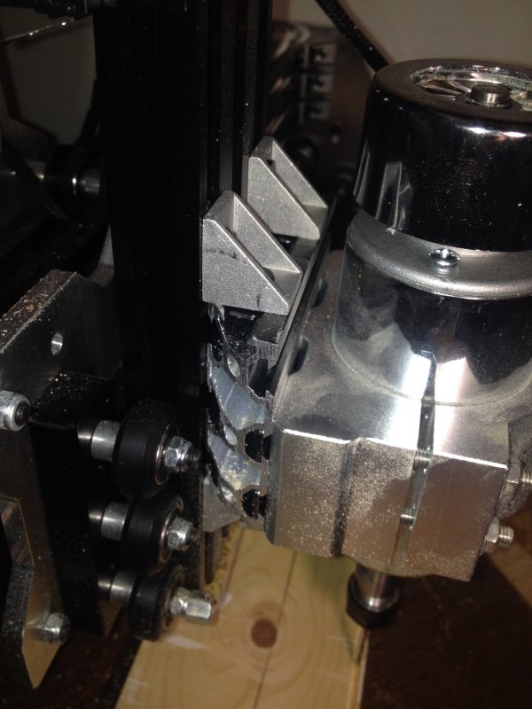

  9. spark2
    spark2 New
    Apr 9, 2014
    Hi Andrew. Really Nice Wire Management. I got a Question. How did you connect the Aluminium-Block of the Spindle with the Z-Axis? That would be interesting for my CNC Build. Thanks for your Help.
  10. andrew Adsit
    andrew Adsit Well-Known
    Jan 27, 2015
    26
    15
    I used a short piece of 20x60 turned 90 degrees. I had to bevel the cut to avoid the wheel nuts, but the al block holes were a perfect match. Them I used 4 pieces of 5mm all thread cut to length with t-nuts in the 20x60 and regular nuts on the top. I'll post a pic in a few.
  11. spark2
    spark2 New
    Apr 9, 2014
    thanks for your Answer. It would be great to see a Pic with your Solution, so i can imagine better. Thanks for your Help.
  12. andrew Adsit
    Jan 27, 2015
    26
    15
    Nick W likes this.
  13. spark2
    spark2 New
    Apr 9, 2014
    thanks for your effort. good idea how u fixed it.
