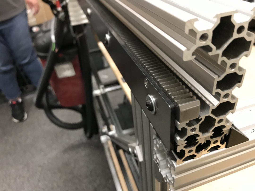

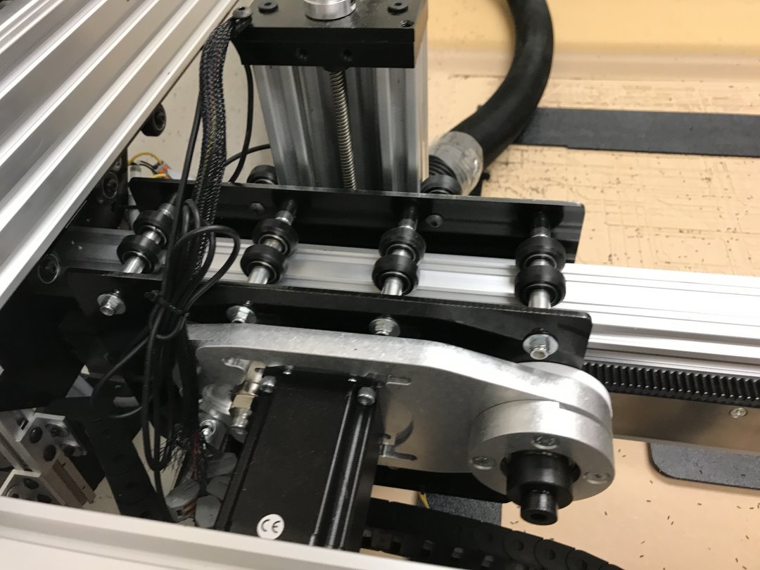

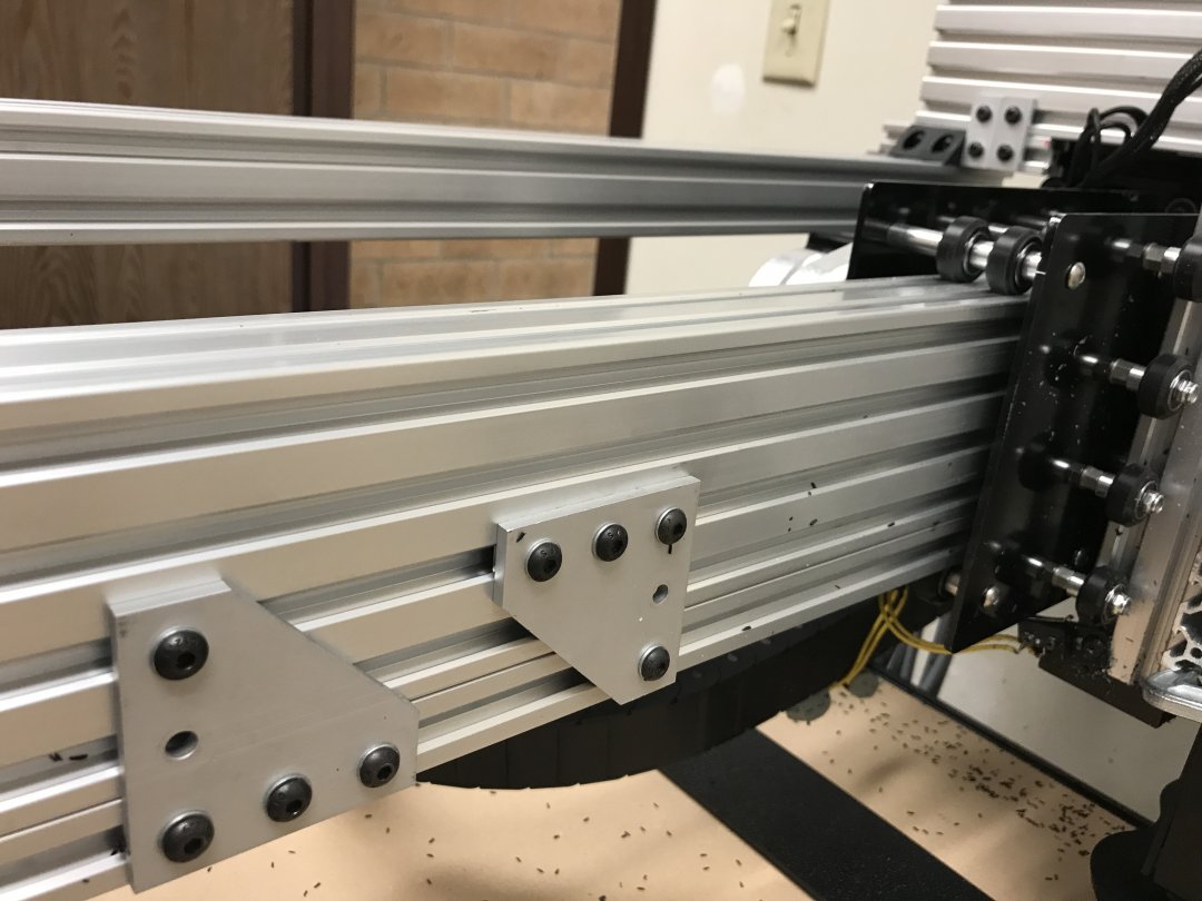

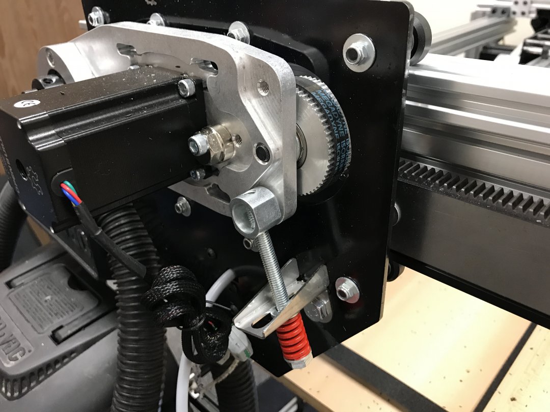

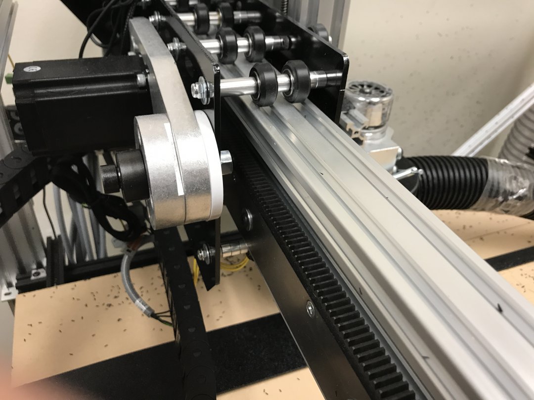

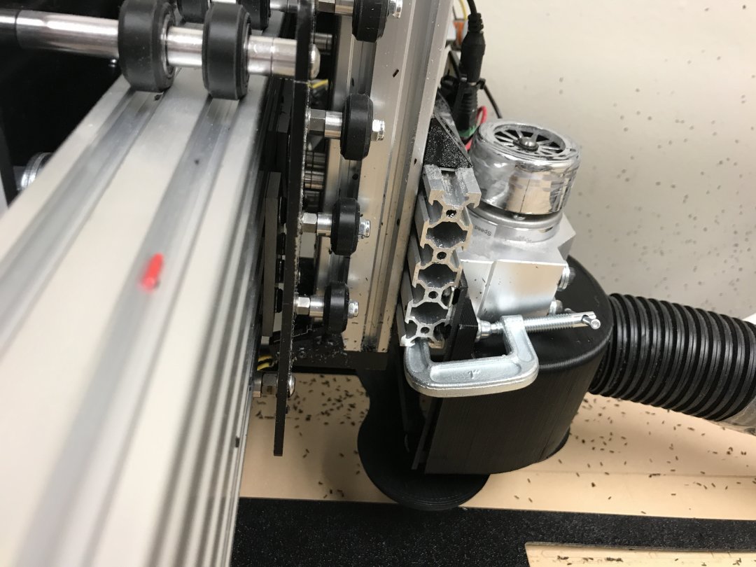

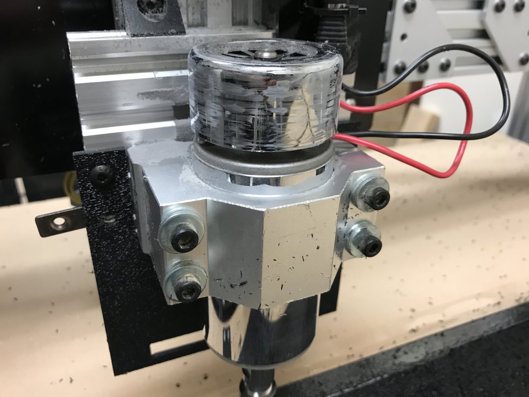

    Photo Aug 13, 8 00 25 PM.jpg Photo Aug 14, 8 48 48 AM.jpg Photo Aug 14, 8 48 56 AM.jpg Photo Aug 14, 8 49 06 AM.jpg Photo Aug 14, 8 49 11 AM.jpg Photo Aug 14, 8 49 16 AM.jpg Photo Aug 14, 8 49 25 AM.jpg I keep meaning to do a proper 'build' writeup. But so far I just haven't found the time. See some attached photographs of the setup. One peculiarity that you might notice is that everything is 'upside down' from how things usually are. This was because my original plan was to have this CNC cutting bed be the bottom of a double-decker CNC machine to allow me to cut two things at the same time and conserve floorspace. But the new machine ended up being so fast that the parts for my second cutting bed which was to sit on top of this are gathering dust atm. I will likely add on a second CNC machine on top at some point.
    You can browse the CAD setup I used to create the custom gantry plates here: Onshape
    I can send DXF files of the custom gantry plates if you want to cut them out exactly the same way yourself. I paid to have them lasercut out of 3.4mm (0.135") hot rolled steel then spray-painted them black. They could be cut out of thicker aluminum as well.
