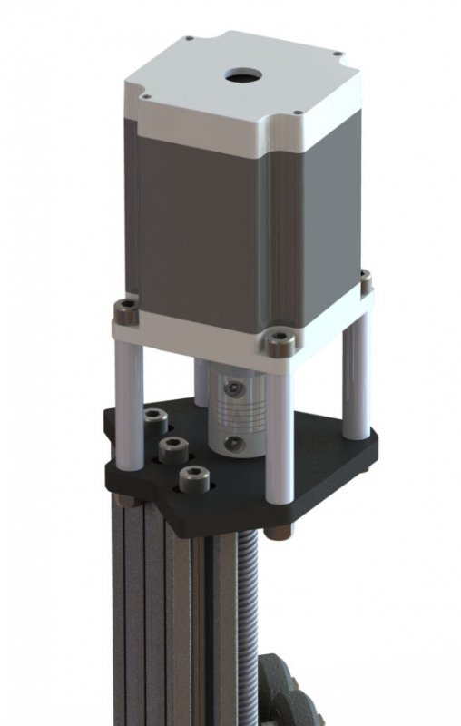

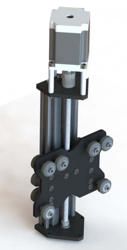

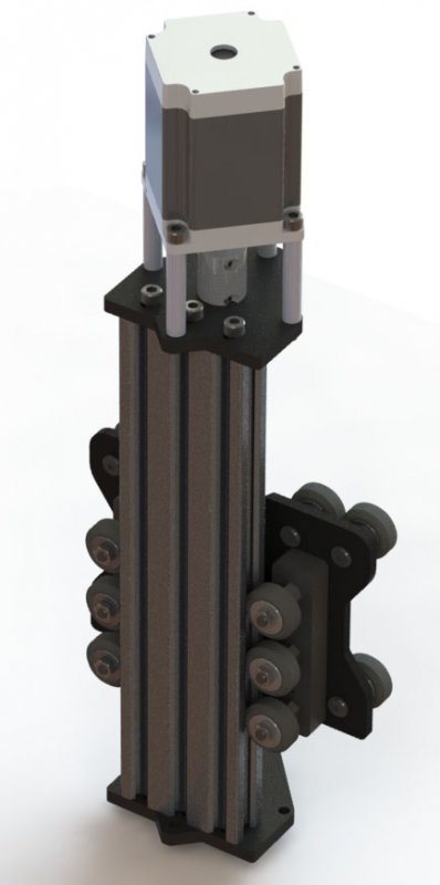

    sgspenceley submitted a new resource:
    SolidWorks Ox assembly - Aluminium OX, complete assembly, authored in SolidWorks 2014,

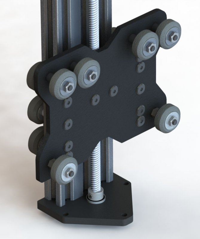

    My build was authored from Marks original files. I noticed the same wheel & extrusion issue in SolidWorks.
    The eccentrics have enough adjustment to make this a non-issue. But I must admit I did change many of the holes distance measurements just to make me "feel better". i.e. Horizontal distances are often not perfect.
    Marks original files were good enough to creates an OX that fit together perfectly.
    I have since re-authored a totally different set of OX models which are more precise using micrometer to measure the real parts...
    I'm not sure it was worth the effort to re-engineer each part but it made me more comfortable for my Linear OX project.
    If I was starting the original project again I would plan on redesigning many of the original parts because there is lots of room to make simple improvements. For example Y axis corner brackets, Z axis nema 23 brackets, etc.
