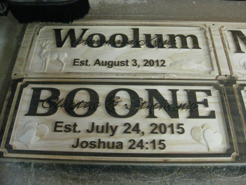

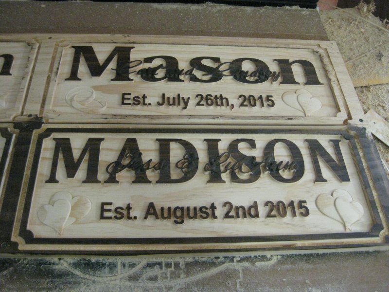

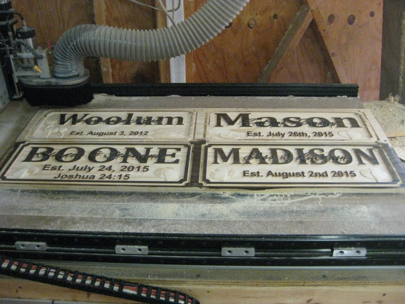

    UPDATE 8/15/2015
    It's been over a month since we installed the delrin wheels and so far so good. We have run this machine pretty hard and cut alot of signs so i'm pretty happy with their performance so far.. I will keep everyone updated if anything changes. Also check out my new build the "Triple Shot R-P-M" it's going to be a 6 watt laser cutter/engraver, a bowden 3D printer with a large heatbed, and a 400-600w CNC router as well. http://www.openbuilds.com/builds/triple-shot-r-p-m-area-51-cnc-parts.2307/
    Here are a few more photos of some signs the F-117 recently cut.
    [​IMG][​IMG][​IMG]
