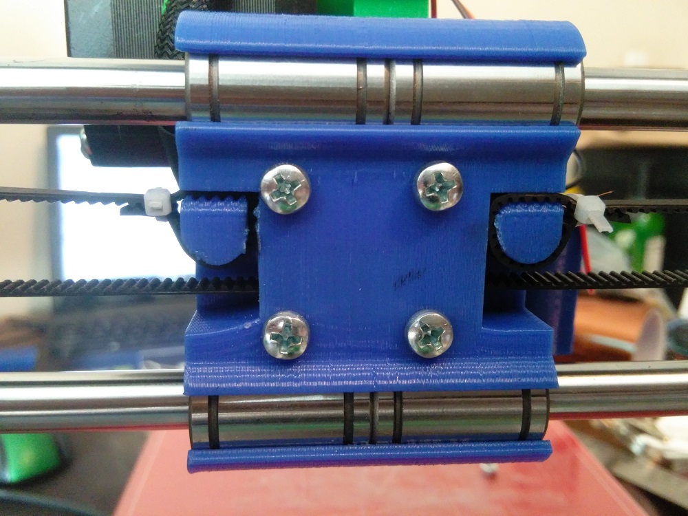

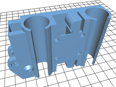

    I started printing parts for the Wilson II, but the STL file does not match the x-carriage design in the doc folder. Has any one else found this?

    The stl file should be for the new updated X-carriage.
    Not the old style, like so. This one is no longer used. The stl file for this one has been removed.

    I printed the new version of the x carriage. The wall between the 4 screws is very thin. I contacted Gethub and he said my thin wall can stay or go. I am using Eric's Oneup 3d printer for the small parts. His core XY should print the rest.My main problem is getting the 10 mm rods and the 2020 extrusion cut to size. The 6 frame pieces are 500 mm and so is 2 of the 10 mm rods. I just don't know what to use to cut 3 500 mm extrusion to 430 mm and the rod to 470 mm and 420 mm ( 2 of each)
