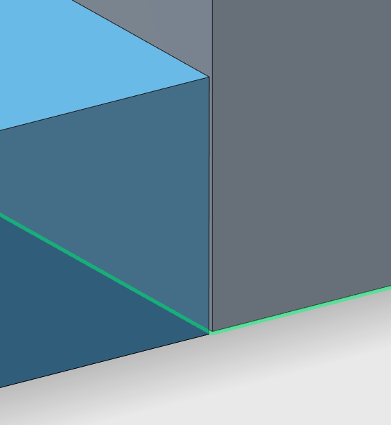

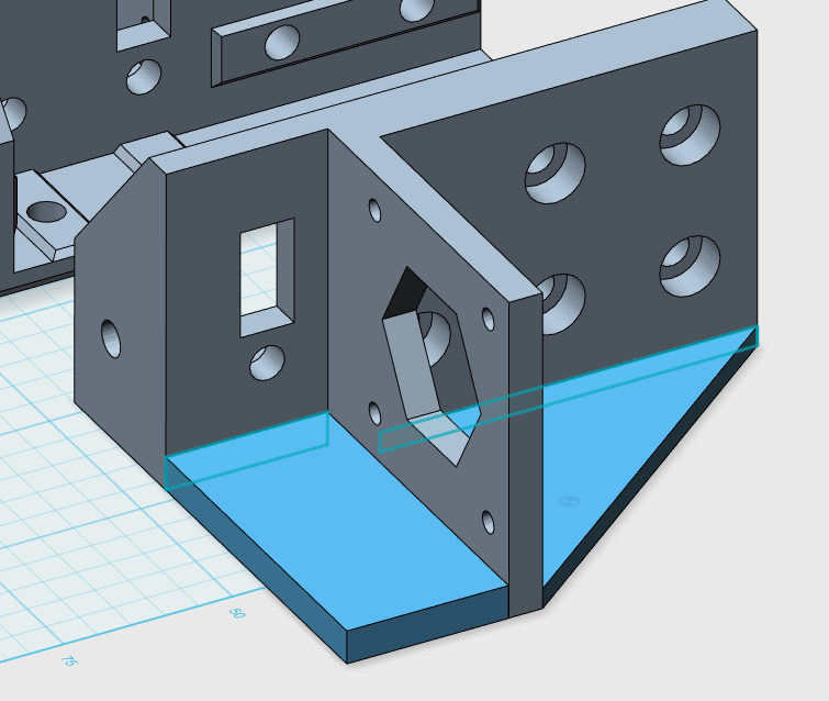

    Changing topics, I have been trying to make my own mods to the XY motor mounts and am completely failing to use 123D. What I am trying to do is move the motors 2mm back from the printer (so the motor housings don't make contact with the printer) and similarly reduce the diagonal supporting bits to 3mm thickness by the motor (again so it doesn't make contact) and buff them to 5mm solid parts on the top. The problem is just my general stupidity I suppose, because I sketch the profile I want on the face of the motor mount and then extrude it, however it seems that when I make the sketch, 123D snaps to the nearest grid point and not the corner vertex. That means it looks ok from far away:
    But if you zoom in you see the bits aren't actually connected. I've tried to be as precise as possible, but no matter how I try to line them up, I only end up with them as close as the grid for that zoom level is.
    I've tried making them as separate pieces then snapping them face to face but that only works for one face and still requires repositioning. How in the heck does one extrude a sub-face that extends from one end of the face to the other? I can do it easily in Sketchup because of how their snapto works, but 123D only has various resolution grid snap?

    I k now that 123D is a lot like Fusion 360 and in Fusion 360 I solve this problem by typing the distance I need it to extrude rather than relying on the snap feature. I am not sure if this is possible in 123D or not because I don't use 123D very often. That being said I can tell you how to get a model from 123d into Fusion 360 if you want.

    The project function is CRITICAL to using 123D due to the lack of a good snap feature onto solids while sketching. It is on the far right of the sketch features. Play around with that a bit and you'll understand while editing anything in 123D is impossible without it.
