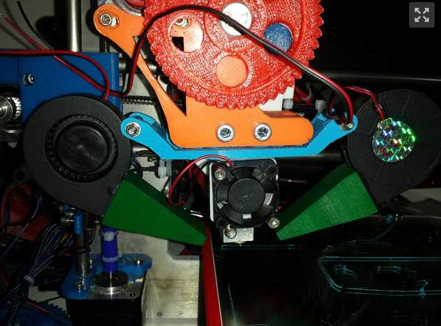

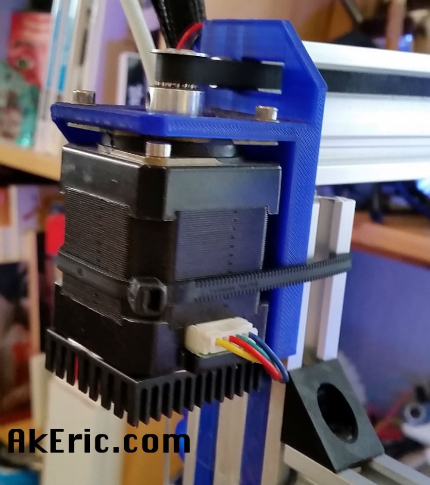

    Not dual blower, but I did do a dual-fan setup. They're not ducted, because the fans I have are so powerful :p Ducting could easily be bolted to them though:
    Big Fan Brackets for C-Bot by AK_Eric

    Hi Eric. Yes I have seen those. I never had much luck with axial fans, but never went that big. Don't you have problems with cooling the bed?

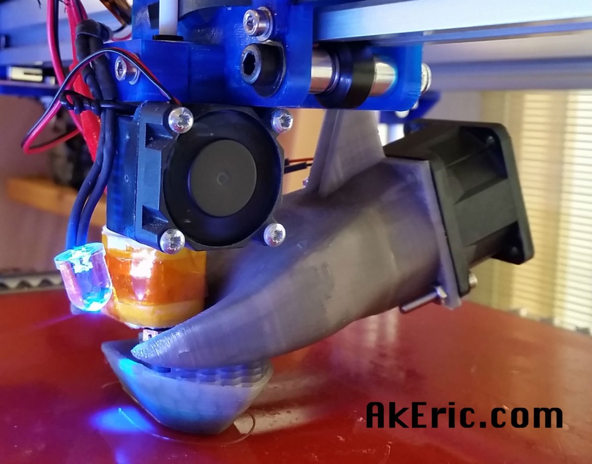

    I actually switched out to a single (big) ducted fan on the back: Just posted about it a few days ago & gave the thingiverse link to the duct.
    Surprisingly, I never had problems with it cooling the bed. Just knocking parts over at full power :p

    Did you have issues without vibration dampeners?

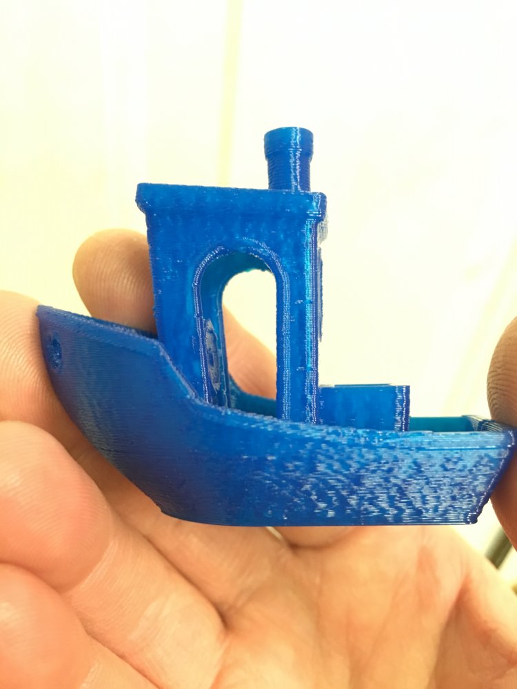

    I thought that I remembered reading that somewhere. Good to know. Any suggestions for a particular model? I assume that they're quite inexpensive. I'm running a 24v/25A power supply.
    Completed my first "benchy" last night. Meh; not bad. Used the 0.8 nozzle and 0.2mm height.

    Never tried without them actually, they've been there since day one.

    Pretty good for a .8mm nozzle as far as lack of blobbing during the retraction.

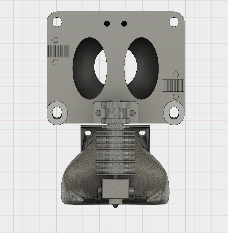

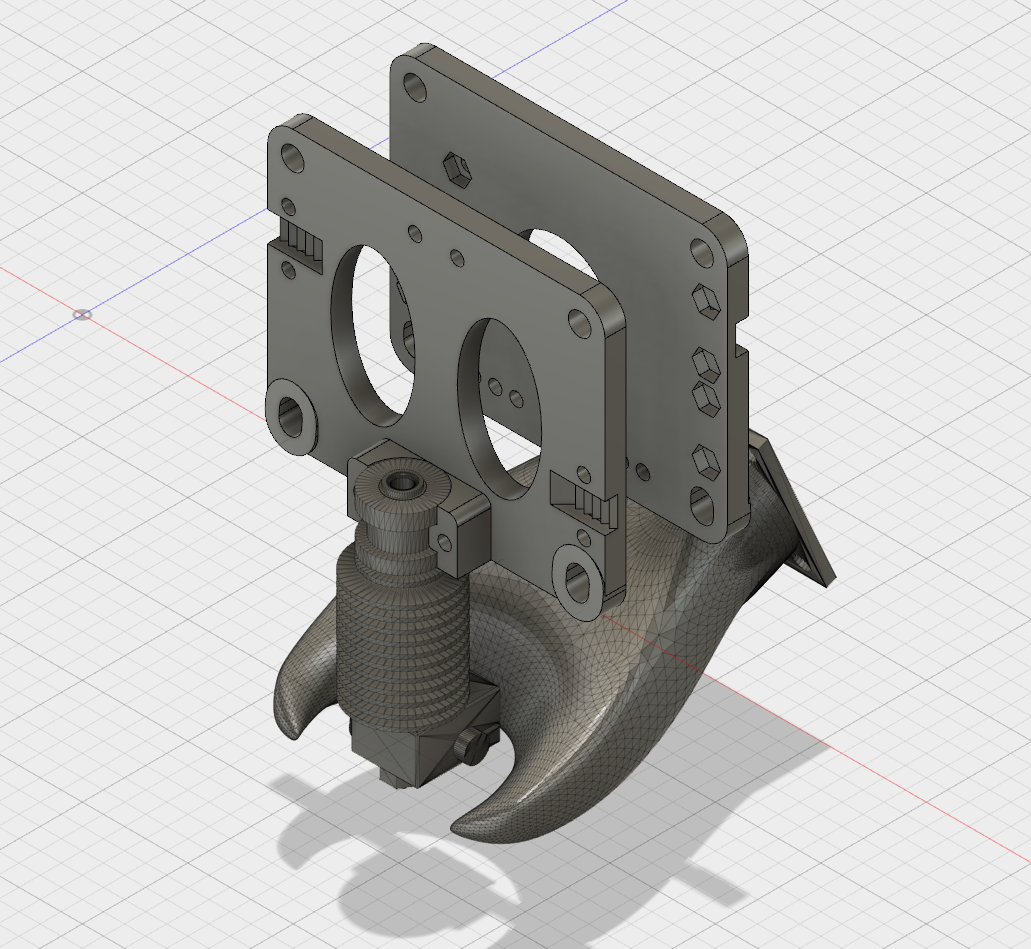

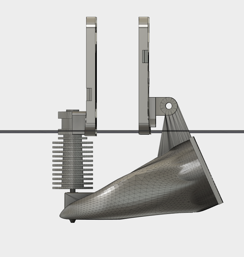

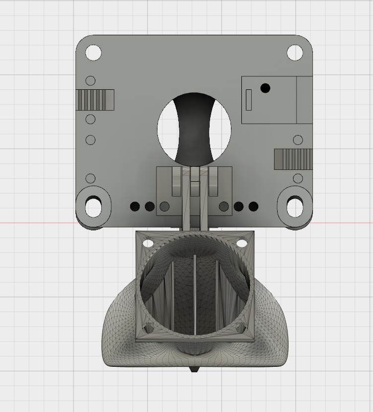

    Here is a "mount" I developed that *should* allow you to connect the @AK Eric fan duct he just developed to the stock hot end gantry. I haven't tested it, but the dimensions are right and everyone knows that nothing can possibly go wrong if the dimensions are right...... If you want the F360 files I used to develop this I am more than happy to provide them to whomever.

    Looks great. I've been trying to do this type of duct for months, on and off, in OpenSCAD... Have any knowledge of OpenSCAD by chance? :)

    LOL no, but I am starting to learn it. I am super comfortable with the syntax but I am still learning how to make things in it ha ha.
    Just to be 1000% clear and fair I didn't develop the duct, AK Eric did, but I designed this LITTLE tiny piece to make it work on the stock setup (he has a Volcano which is taller, etc...)

    Ooh! I was eyeballing AK Eric's nice fan duct and was going to work on a bracket to adapt to the rear plate for us regular E3D users, but you beat me to it! Good man. I'll probably try this out tonight.

    I've poked at it, and I like it: Good for parametric stuff. But no, I don't 'know' it.
    I modeled up that duct in Maya out of pure polys, so there's no way to 'get it into openscad'. You'd have to model up something similar there from scratch. I've been using Maya nearly every day of my life since it came out ('98-ish?) and Alias PowerAnimator before that, so... I have a bit of momentum behind my software choices :p
    Really, I should just change that duct so rather than a hole for where it connects to the bracket, it's just a "long open space": Then it could slide up\down as needed for different extruder systems. I modeled it really fast as a prototype. If I get some free cycles I'll try to modify it to be a bit more adjustable. But @Matt Mathias mount is a great alternative!
