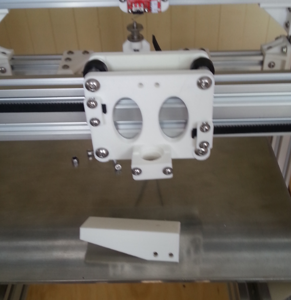

    I am trying to implement a cable chain to keep things tidy using the STLs in the "Wiring Accessories by Elmo Clarity". Something like that shown on page 84 of this thread. How does the chain connect to the top of the carriage? I thought it used the X Axis Support Base, but it appears to be back to front. It is also slightly too big to attach to the two holes where I think it should go.
    I need some more pictures please....
  13. Elmo Clarity
    Elmo Clarity Journeyman
    Jan 17, 2015
    505
    149
    I originally used the direct drive version of the carriage and it has a tab on top that I mounted to. I now use a carriage for the E3D Titan exturder and I put the tab on it too.
    Here is an image of the direct drive front carriage. You can see the tab on the top. The picture you have shows the mount point at the top, but because it isn't extended, it might not fit. You could probably print a small piece to bolt on to the existing mount and make a tab.
    NeoGames76 and IanT like this.
  14. IanT
    IanT New
    Mar 30, 2016
    21
    Thanks. The fit is very close. I will rework the part. I still do not understand why it appears to be back to front. Maybe my understanding of how I should be implementing the chain is wrong. Should it come out of the top of the carriage to the left (as the part is drawn) or to the right (As per the picture on page 88)?

    I'm not sure exactly what you are meaning, but here are a couple close up pictures of how it is mounted. Hopefully they will give you the information you need.

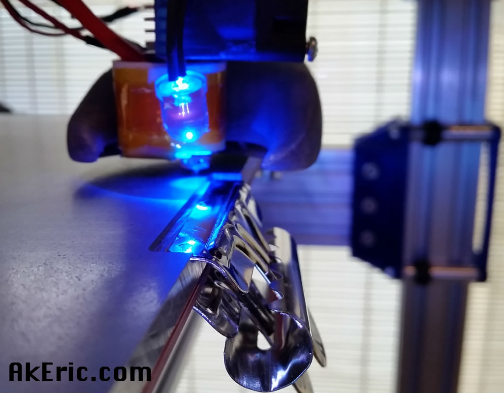

    Bit of shown-and-tell: I recently used my X-Carve CNC to machine a mic6 aluminum removable build plate for my C-Bot.
    Ended up doing three separate cuts on it:
    * Create a pocket in each corner to allow for clearance around the HBP bolt heads.
    * Create a pocket on the top of each side to allow for recessed bulldog clips.
    * Create a channel in the bottom to tape in the thermistor: This also means I had to install a barrel-jack into my thermistor line allowing it to be decoupled from the printer during plate removal.
    Came out great, I'm really happy with it.

    Very nice! i did something similar, but with my drill press and a dremel. Your cuts are much cleaner looking. Great job!

    If you happen to do this again, you might want to think about moving the thermistor to the rear and mounting it up E3D style. The temp indicated are closer to the surface temp and it shows the actual temp of the plate itself.

    Not quite following you: As is, my thermistor is in the middle of the plate (on XY), not touching the HPB at all, but the core of the aluminum plate itself on Z: The heat will really have to saturate the plate before the thermistor will start detecting it, thus giving a pretty accurate read.
    Do you have a pic of what you're talking about?

    I'm printing at the moment but caught the head of the bolt holding the thermistor in. It's the small bolt next to This is the exact same setup that E3D using on their hot ends. I picked it up the instructions from Tom Sanladerer, video link below.

    AH, I got you, thanks for the pics. In fact, I did see that guide back in the day.
    I didn't go that route for the main reason I feel the back of the bed (my bed at least), in the center, heats faster than the rest of it, where the leads meet it. Just holding my finger there I can tell a difference. I figured the 'center' of the bed would give me the most accurate reading.
