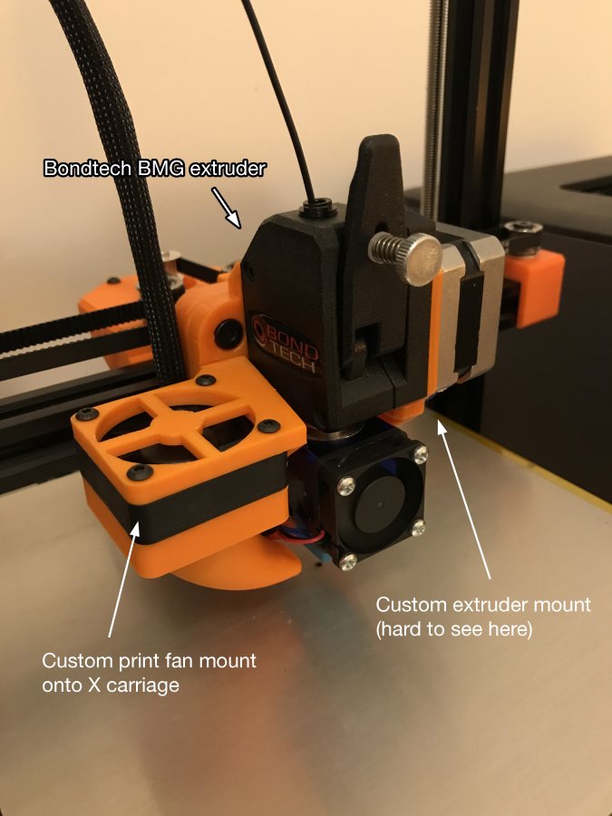

    I'd like to share this repository which represents my build of this printer:
    GitHub - loglow/TrueUp-Glide-Mod
    I'll keep updating it as things continue to progress.

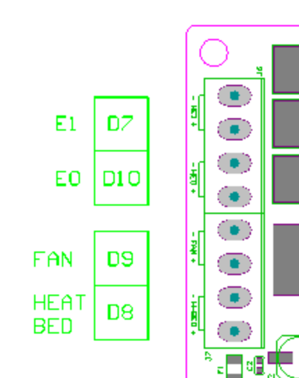

    I wanted to share a detail that I encountered. The MKS Gen v1.4 often comes with one of its two power screw-terminal blocks missing. Mine did. And the vast majority of photos of the board in product listings are also missing the second terminal block. See attached image for an illustration of what I'm talking about. In fact, I could only find one listing (out of hundreds) that showed the second block populated (4 layers PCB controller board MKS Gen V1.4 integrated mainboard compatible Ramps1.4/Mega2560 R3 support a4988/DRV8-in 3D Printer Parts & Accessories from Computer & Office on Aliexpress.com | Alibaba Group).
    Things might be fine with only one set of power inputs from the PSU. I don't know, and I haven't tested it. But Keith's assembly guide describes two sets of power cables going into two sets of terminal blocks, presumably to accommodate the necessary current. You could solder wires to the board directly, or you could install a second block, which is what I felt like doing. The spacing is tight, it's designed for a matching terminal to interlock with the one next to it, so you'd either have to remove the existing one and install a new 4-position 5 mm block, or find a compatible 2-position block.
    So, if you want to install a second terminal block on your board, I did find one on Digi-Key that is compatible. It's not exactly the same, probably because it's not made by the same manufacturer, but it's extremely close to the original, so much so that it even mates correctly with the two little existing interlocking grooves. Here it is for 92 cents: https://www.digikey.com/product-detail/en/OSTVJ020152/ED2755-ND

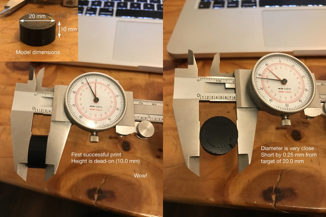

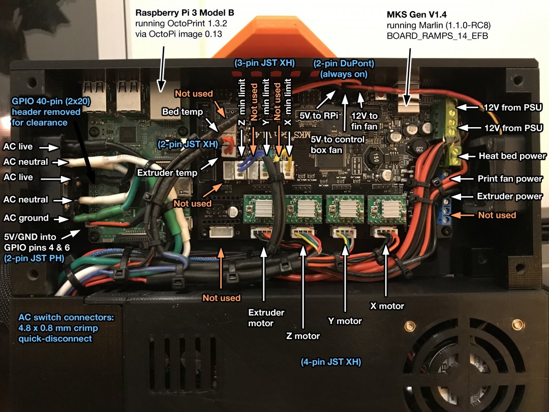

    Here are a few early questions I have regarding the firmware:
    Why is the following defined:
    #define MOTHERBOARD BOARD_RAMPS_13_EEB //****Don't change this
    When this build uses a RAMPS 1.4 board with one extruder?
    Also, why is DEFAULT_AXIS_STEPS_PER_UNIT defined with the values 99,99,1600 and not 100,100,3200?
    Finally, I decided to try a quick test of the latest Marlin release candidate (1.1.0-RC8) but receive an error & disconnect whenever the hotend is instructed to heat up. Is there a particular reason to be using an older Marlin release (1.1.0-RC3) from several years ago? The newer release has some nice features like minimum Z homing height, extruder parking location, nozzle cleaning routines, etc.
    I did just successfully (sort of) run the first print (the calibration object) on my finished build! Bed adherence was poor so it lifted off after about 4 layers, but hey, it's a start, and it proves that all the motors, the endstops, the heaters and temp sensors, and extruder & hotend are all basically doing what they're supposed to do.
    So, next steps are looking into adjusting print bed offset (the print was much too far forward on the bed), Z0 & bed temp re: warping/adhesion, and tweaking the firmware settings...
    Have a nice night :)

    I'm going to reply to my earlier post here, for the benefit of anyone else who might be interested :p
    I successfully got he latest Marlin release (1.1.0-RC8) working. I'm still not sure why Keith decided to use the BOARD_RAMPS_13_EEB setting with the MKS Gen V1.4 board. The newer Marlin release does some fancier auto-checking to determine the EEB/EEF/EFB (etc.) wiring (see "Augmentation for auto-assigning RAMPS plugs" in pins_RAMPS.h) which is why the newer version still wasn't working even with the original motherboard setting. Anyway, I set the board to BOARD_RAMPS_14_EFB and rewired the control box to match up with the MKS Gen V1.4 spec, which is (from top to bottom):
    • D7 = E1 (not used)
    • D10 = E0 (extruder)
    • D9 = FAN (print fan)
    • D8 = HEAT BED
    Coincidentally (or not) this also matches the markings on the PCB. This got everything working fine with the latest Marlin. My configuration file is here (customized Marlin configuration file · loglow/TrueUp-Glide-Mod@85b6a07 · GitHub) and I committed the default one first so that all the customizations are easy to see with diff highlighting.

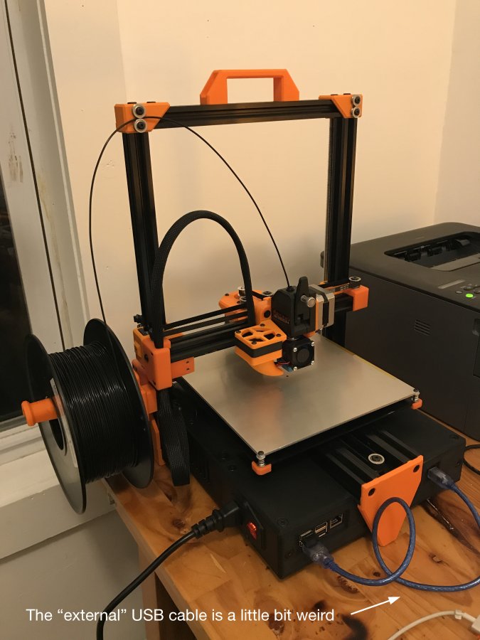

    Anyway, I have to say, this build is just awesome. My first full print came out better than anything that I ever "successfully" printed with the little M3D Micro that a friend lent me, even after months of tweaking the calibration, settings, and build surface. All I have left to do now is fine-tune all the calibration and settings stuff (temps, speeds, slicing, etc.) in order to get perfect prints. Below are some photos of the finished build and of the control box wiring.
    Thanks Keith!

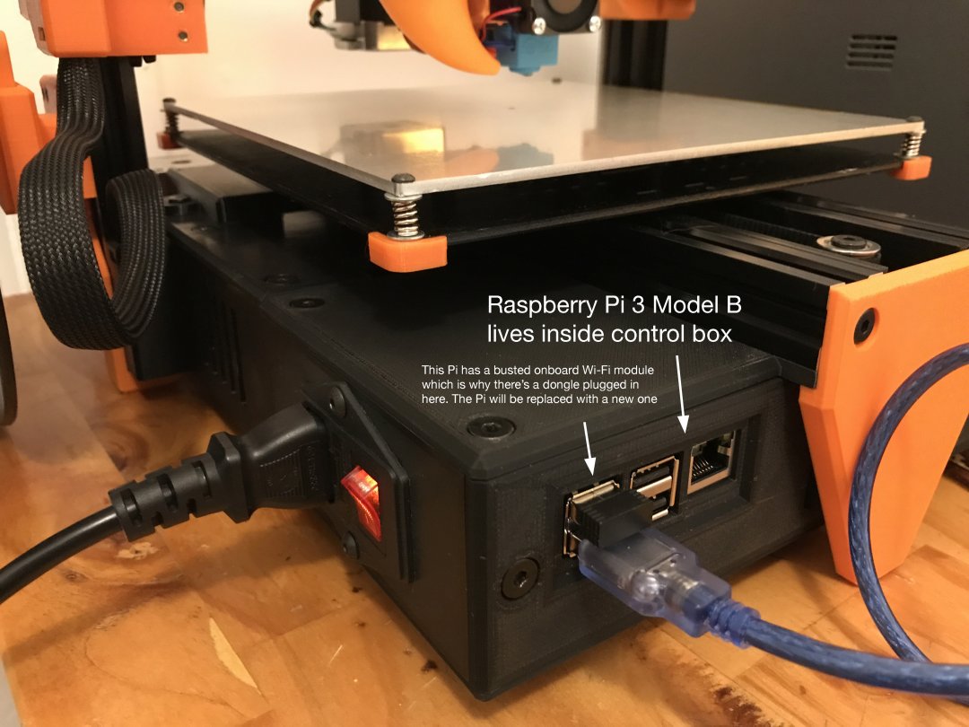

    The MKS Gen board has headers specifically for this purpose. See: MKS GEN - RepRapWiki (Smart Controller section)
    Alternatively, you can use a Raspberry Pi (preferably a 3 since it has onboard Wi-Fi) running OctoPrint. I like this method since you can then use any other computer with a web browser as a monitor & control interface, and you don't need to fiddle with awkward little menus or buttons.
    Hope this helps!
