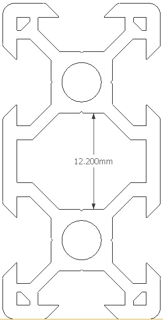

What is this missing dimension?

    From top to bottom (in the above side view) as well.

    Sketchup says 12.2mm (0.480"). Hope that helps.

    Oh, thank you (I wish I knew how to use sketchup but I use Solidworks instead). By the way what does it say the other dimension is? The one in the other direction but still that open area in the middle of the beam.
    Thank you so much.

    I measure between 12.06mm and 12.08mm horizontally and between 16.44 and 16.48 vertically (according to your drawing). Sketchup measuring tape is known to be inaccurate...

    The official measure vertically is 16.4mm and 12.2mm in horizontally (extrapolated from the other dimensions)

    Perfect. Way enough space for a GT2/GT3 belt to go in there times two.

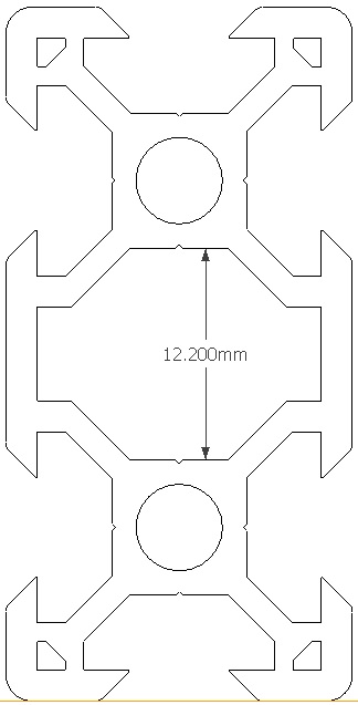

    Credits to Mark (mqbeers)
    The dimensions are the 6.1 and 8.2 where the font is slightly bigger.
    The rest of the drawing is mirrored horizontal an vertically to complete the picture.
    So as dddman said, 12.2mm (6.1 * 2) in the drawing below, but now you also have all the other dimensions.
    Why you have issues in Solidworks?
    Make a new sketch in SW, using the picture and dimensions you do have.
    Keep in mind that everything is symmetrical, so in SW, you can shift-click select more than one drawing segment in your sketch, and then create a condition between the two objects (=, symmetrical, perpendicular, etc.) With this way, the "missing" dimensions become accurate.
    Then, in SW, while in sketching mode, click the dynamic dimensions tool, select the one edge and then the other, and it will add the dimensions as you see in the picture above. If you see lots of decimal digits, like 6.1239432mm, you most likely made some drawing mistake somewhere. 10 microns, 0.01 mm on linear sketch lines is a good indication that you on the right track.

    The thing is the drawing I showed is what is on the page and those dimensions are not listed. Why they are not I do not understand.
